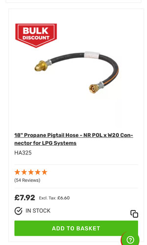

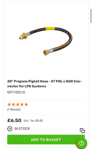

The connection you have is specifically for screw on Butane cylinders. However the regulator is compatible with both Butane and Propane, and all you need to do is to get the Pigtail ( the flexible hose with the butane connector) changed to a Propane Pigtail.

The cost of buying a Propane pigtail is typically between £10 to £15, If you are competent you can change it your self, but its literally a 5min job .
