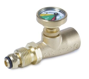

Sorry meant to say gas stop valve one of these.

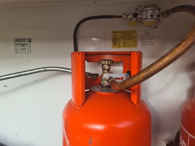

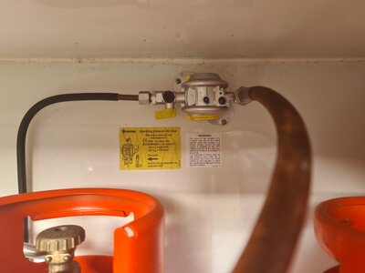

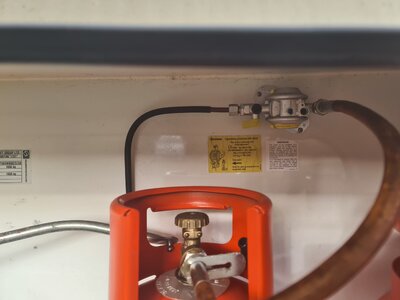

This is a picture of my bottles.

The chances of a hose rupturing is very small and usually they go when pressure is first applied i.e. when you are there , so IMO it's really not necessary and if a gas pipe downstream of the regulator fails , the regulator will limit the flow and it is unlikely to trigger the unit. A pressure gauge is more susceptible to failure. So you are introducing another potential leakage point( joint and gauge).The gas locker is designed so that in the event of a gas leak , there are no sources of ignition in it ( unless you insert one, gas torch , camping lantern spare battery e.t.c) and the gas drops allow the escaped gas to dissipate. I got one as I have to perform letby testing and 1/3 of Calor gas bottle valves leak, so I thought I could isolate the bottle , but only a rush of gas will switch it off , you can only reset by pressing the pressure gauge , so it sits in my gas equipment toolbox gathering dust.

In respect to knowing the LPG quantity left a pressure gauge based indication is near useless as the pressure depends on draw off demands, product temperature and product's state, liquid or gas, some of which can be dynamic.
So as stated why in trying to make things safer introduce additional risk for little of use info?

The post isn't about auto changeover valves, it's about a valve that shuts off the gas supply in the event of a catastrophic leak.

I'm inclined to agree with IanB's assessment of the situation. When you look at the risk profile of a caravan LPG system, the vast majority of the system is is made from solid copper and brass items. These are inherently strong and long lasting and as such th erisk of burst failure is very very small. The most vulnerable parts are the pigtails between the gas cylinder and the regulator and the regulators internal diaphragm, but considering the usage case, these are all quite well protected inside the gas cylinder locker and are unlikely to be snagged when towing.
Of course whilst towing the gas bottles should be turned off at the valve on the bottle anyway.
Again as IanB points out, by introducing the device into the system, you are actually introducing another potential failure point. And you also need to consider how to check your safety device safely.
There can be a value to a pressure gauge if you understand how an LPG cylinder works, becasue as has again be stated the actual bottle pressure is determined by the type of gas you are using (liquefied Propane temperature and pressure coefficient is very different to Butane ) and will vary with the temperature of the vapour fill in the cylinder. In practice a pressure gauge tells you nothing about how full a cylinder is with LPG, as long as there is some liquefied content in th e cylinder the vapour pressure is solely determined by the temperature of the cylinder, the gauge will only really show a reducing pressure when all the liquified content has boiled off to vapour and it is used up.
I'm sure there are situations where such a device has some real safety purpose, and whilst it won't harm your system, I can't see it providing any real safety value to a touring caravan.
Just follow normal caravanning good practice of ensuring your gas cylinder valve is properly turned of when ever traveling.
This is an example of a solution searching for a problem and I rate it alongside Tyre bands which is a whole separate debate.
19,275
4,465
I should also add that such device need to be sized correctly to the system theri being installed in. The trigger flow that causes the valve to close should be selected to be just higher than the peak demand of all installed applainces operating at the same time, other wise especially with the smaller 8mm copper pipe used in caravans, the pipes natural resistance to flow may limit the open flow rate and prevent the device from triggering.
