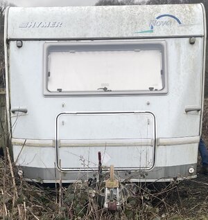

Here’s the pic I took today, it’s grim!
It’ll be a mountain but we’re looking forward to getting stuck in.

Welcome to to Forum Blake,
Great story and interesting photo.. Our roof gets green after a couple of years needing some Fenwicks concentrated cleaner and the mandatory Elbow Grease🤪. I think yours will clean up very well.
One word of caution. I see the handbrake is fully applied. It is possible the brake shoes may have stuck to the drums and may not release . In practice I find it best to chock the wheels and leave the hand brake off in storage.
Keep us posted with your progress please.

Thank you. I’ll make a note to look at that when we head back later this week.

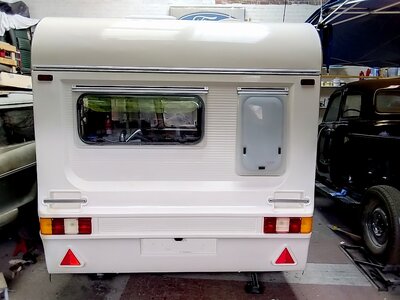

Just had a look, I’ll check out the Blaze stuff. Lovely example of how nice a van can stay when well maintained!
Blaze is an excellent cleaning product,,read the instructions,it can be diluted to more than 50:1,Also read up on autoglym products and don't use anything abrasive as there isn't an over abundance of paint
