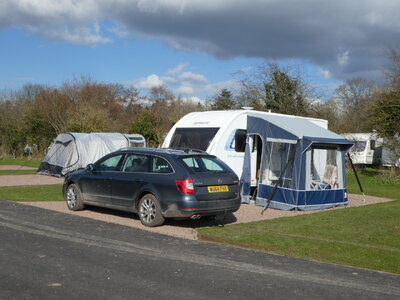

We had a 2014 Superb 4WD auto DSG diesel 2.0 litre estate. A really accomplished car and very economical solo or towing. I’m 6 ft 4 in and even with the front seat fully back I could sit comfortably in the rear seats without crushing my knees. The load area is very large and I had to lean forwards just to place stuff at the front end of the load area. Installed roof load rails too.
Skoda benefit from reasonable service costs with plenty of independent VAG service centres who can use VAG diagnostic software and upload service details to the VAG database.
I had a Gen 3 Volvo XC70 AWD and the Skoda knocked it for six in many areas. Oh and it was a great towcar.Even the rear seat bases pull forwards and give a transverse load area across the rear of that area. Great for awning or heavy boxes/kit. Might seem OTT for your current needs but it would future proof you if you went for a larger caravan in the future.
