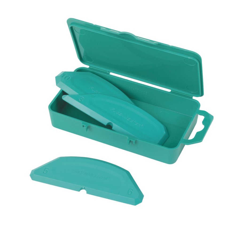

Sometimes if you are over enthusiastic when cutting the top off the mastic tube this can happen, it’s just the non treaded tip that needs to be cut, if you trim some thread with it then that’s when this issue can arise.
As said water with a dash of washing up liquid sprayed onto the bead of mastic, then I use
I read somewhere using spit and applying sealant with your finger introduces bacteria that can cause mould further down the road
