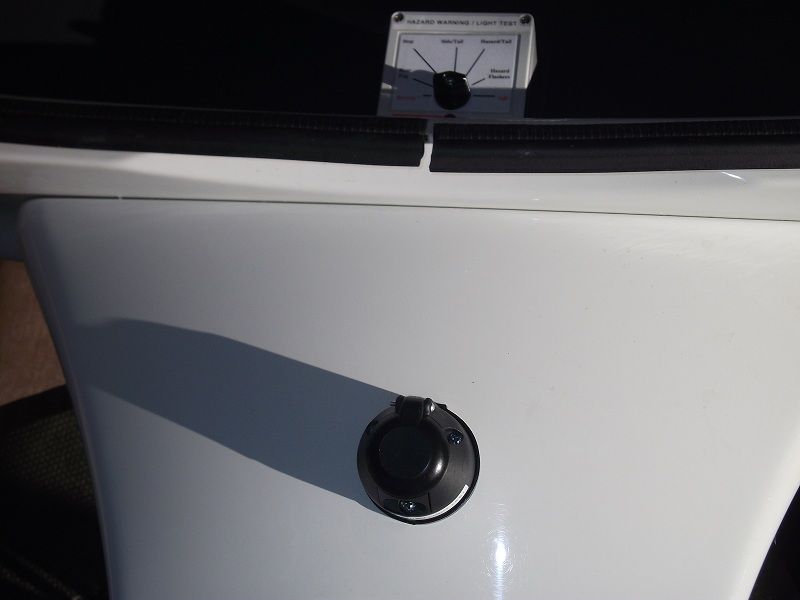

I've finally managed to get my hazard flasher / light test unit fitted and I'm delighted with the result.
The power to the polycarbonate insulated box is via a 15amp fuse at source and taken from the master switch for the power mover so therefore only powered up when the motor mover is in use. I have a flashing LED light on top of the box to indicate when power is on and note no cabling is passed through the inside of the locker but goes under the floor.
Here is a photo of some of the basic components i.e. the plycarbonate insulated box, multi position rotary switch with knob and standard flasher unit. I have also used a new additional 7 pin pre wired socket of which the 7 core cable is shortened back to suit.
http://i263.photobucket.com/albums/ii129/JimJamieson/DSCF6409_zpsd2f913fa.jpg
I made up the labelling for the box on the PC then printed it onto some nice pearlescent card, laminated it then trimmed to suit. I first made this up with the switch operating as clockwise from the off position as most switches do, but then found my switch operated in an anti clockwise from off position so I had to re make the label. Additional labelling for power and to the extra 7 pin socket was made with a Brother labelling machine and is waterproof. Below is the fitted unit inside the front locker.
http://i263.photobucket.com/albums/ii129/JimJamieson/DSCF6480_zpsc4923c83.jpg
Finally this is a photo showing the front panel with the extra 7 pin socket and the open locker with the control unit. I had to place the socket farther forward on the panel than I would have preferred, to allow the front locker door to open when the caravan plug was connected to the new socket.
http://i263.photobucket.com/albums/ii129/JimJamieson/DSCF6481_zpsa889d2ca.jpg
So now I can also check all my caravan lights myself especially the brake lights without being connected to the car. I can have the hazard flashers on with or without the side & tail lights using the rotary switch with the additional positions for all other light circuits.
The overall cost was quite surprising at almost £46 and that did not include the flasher unit or the LED which I already had in my workshop.
4,638
Very impressive and well presented
I made up this unit over a decade ago and use it frequently for checking the lights
It belongs more to a mechanical rather than an electronic age compared to yours
A flasher unit would be a good addition
