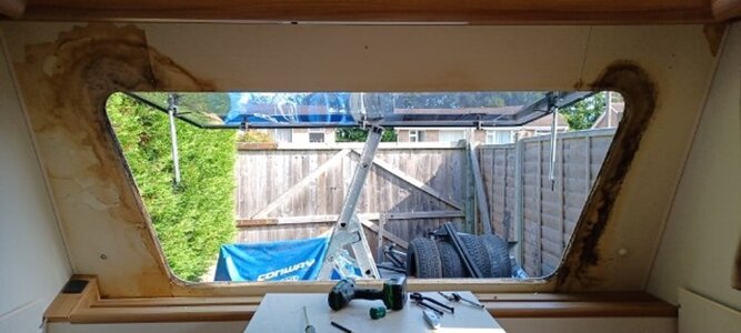

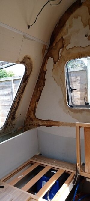

On close inspection found soft wall ( see pic) about 3" at the top of window.
My question is is it DIYable?
I am a fairly hands on guy, understand I need to find source of leak, reseal, cut out and replace.
OR does anyone have idea of cost?
Thanks guys

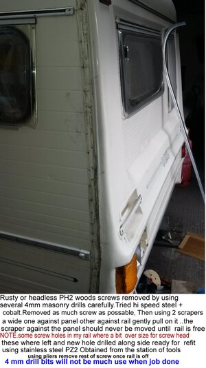

It doesn't look a formidable or life threating problem Brewster,if you look on this forum under Abbey I've put images of awning rail removal,cleaning and the correct sealer,if you need any more info there will be other articles on here.Good luck ...Gary
