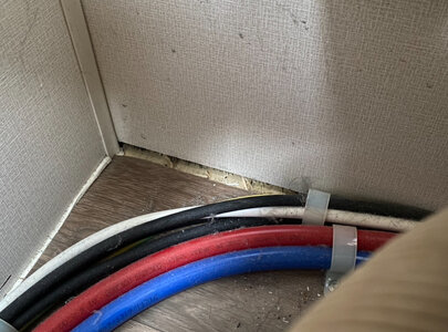

I’ve got a Swift Challenger sport 586 (2015). We’ve had it since new. No damage to it that I know of since I’ve had it (family pride and joy!)

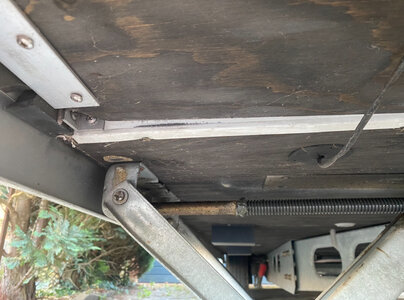

I’ve just got it out of storage (indoors) after the winter and noticed that one of the front corner steady winders has dropped.

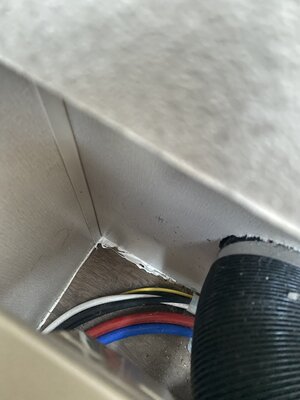

On closer inspection the floor on the front corner has dropped, can be seen on the underside and can be seen on the inside front corner.
We’re due to be going away on Friday for half term hols next week - I can just about lower the leg now but don’t want to make it worse by driving it 100 miles to where we’re going.
No idea how this can have happened! Anyone any advice? Thanks in advance!

A bit more googling last night got me back to a post on this site!
I think this is what’s happened to mine, but I might have caught it fairly early as it’s only dropped 1/2”
Anyone had experience of rectifying this?

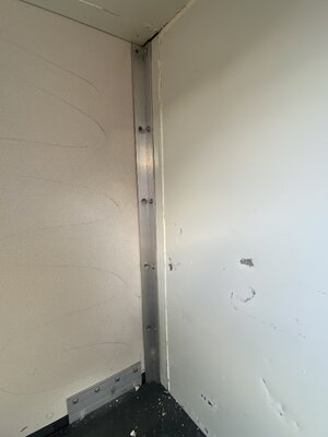

I removed the locker side panel and found the aluminium bracket. All the screws holding it onto the caravan side had either gone or were bent and most of the way out. There was a 1/2” gap at the top, which corresponded with the amount it had dropped!
Roughly following the steps in the Swift service bulletin posted on the previous thread I’ve tackled it myself (being a reasonably competent person!).
First I filled the gap inside with Silkaflex (the Swift approach is to remove the side rail and do it from the outside but that’s beyond my level so have attacked it from the inside):

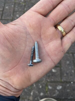

I then jacked the leg up which raised the floor and aluminium bracket into line. Using some larger 6.3 x 25 screws:

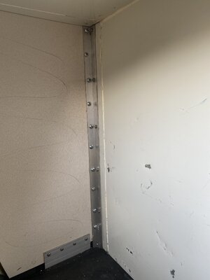

…I placed them in the old holes along with some new holes drilled with a shiny new 6.5mm drill bit:
The silkaflex (sticks like sh!t to a blanket!) had squeezed out a bit on the inside so after cleaning that I’m now leaving it a few days before attempting to tow it at the weekend. I’ll keep the side panel off inside the locker and keep an eye on the screws. When back from hols I’ll probably do a pre-emptive strike on the good corner.
Hope that’s of use to someone. I’m obviously not recommending this approach to anyone - you do yours ‘n-all, but just a record of what I’ve done with mine. I’ll post a final update when back off hols to record whether it’s held!

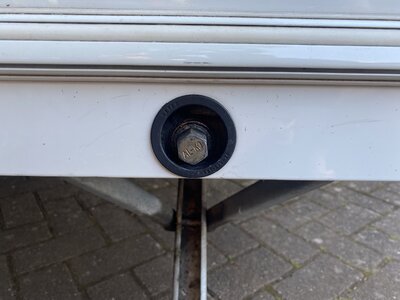

That said I do seem to recall that some owners reported that their floor went the other way and the corner steady screw was too high in the access hole in the side skirt.
