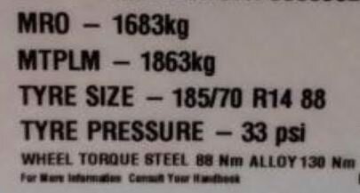

I’m looking for some advise quickly, before I agree to the A/C being fitted to my new Swift Challenger Grande SE 670, we pick the new caravan up on the 9th October.
The original plate has MRO 1683kg and MTPLM 1863kg, the MTPLM is now updated to 2000kg, I have driven with a trailer before but not a caravan.
Am I right in saying as a new caravan driver I should be looking at the 85% rule, which with my car is about (2118 x 85/100) is 1800.
- 1800 - 1683 leaves 117kg payload available?
Or should I be going with maximum Tow KG which is 2400 x 85/100?
We have already had AWD Powrtouch Motor movers added which is 70kg, 2 x TV’s at 6.4kg and a battery which is I presume is 20kg, plus the decision about the A/C at 28kg,
this already takes us up to 124kg, and that's without pots and pans, plates cutlery and the likes., so we have already went over.... arghhhh
Can you please correct me if I’m wrong with my calculations, and help me as I’m stressing out about the weights again.

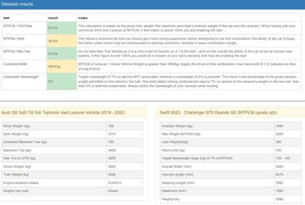

I have attached the weight results below from Towsafe, but I can see they have the Unladen and user payload wrong, as per plat eon carvan also posted.

The calculation of the NCC Towing Ratio is caravan MTPLM times 100 divided by car kerbweight - so 2000 x 100 / 2118 = 94%.
You'll get some who dismiss the 85% guideline while others think it's a good place for beginners to start.

The calculation uses the MTPLM, ie full payload in the caravan and zero payload in the car regardless of how much you actually take - it uses the worst case, ie heaviest caravan with lightest car. You can't "adjust" the Towing Ratio by reducing your payload.
Your car/caravan will have a Towing Ratio of 94%, end of - in reality you should be asking whether that ratio is acceptable for a beginner - personally I think it's on the high side.
So the 2118 is without passengers. suitcases, awning and fuel and bits and bobs?
In theory that would increase to possibly 2300+ give or take, which would make the recommended % improve?

The actual ratio is always lower than the NCC Towing Ratio - no-one has published a guideline for the actual ratio so it can't be used in a numeric way.
The only way to change the NCC Towing Ratio is to change the car or caravan.
