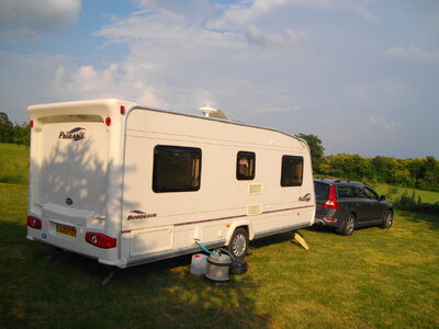

I had a Gen.3 2010 XC70 D5 AWD auto. It towed a 1400kg van over Britain and southern France. Even drove it solo to Krakow via Prague and back via Saxony. A very refined car although its rear leg room isn’t as good as others I’ve had. I’m 6 ft 4 and could not sit behind my drivers seat. Also the luggage compartment isn’t the biggest. My follow on Superb 4wd estate had oodles more passenger and luggage space. But I enjoyed the Volvo and that engine is a real gem. Over 4 years no problems although several recalls on oil level sensing and as auxiliary belts nit cam belt. Fuel about 40 mpg solo. Superb did 50+ solo.
