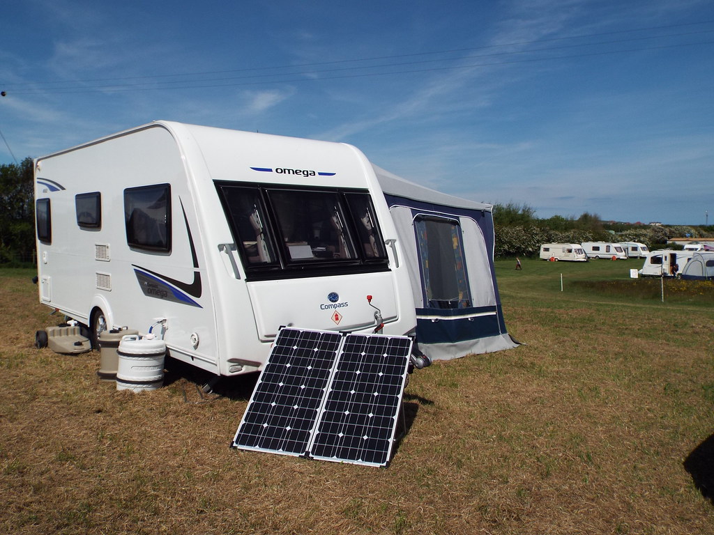

Never worries me, 12 nights so far and the 110amp battery is always charged by lunchtime or afternoon if cloudy even using 12v TV 4hrs a night. Solar is the way to go off grid. (Mine is a 150w panel)

If you're going to regularly away from ehu, I would suggest going for a 110 battery and a free standing solar panel of at least 50w or roof mounted of at least 100w. That way you won't have any problems. As it is your current set up, imho, won't last you five nights.

Whilst I think you would just make it based on your assumptions, for that little bit of added security Martins suggestion of a 110Ah battery does seem logical. Or rather than spend on a new battery, invest in a solar panel. - even 20W one would help to offset some of the power the usage.
