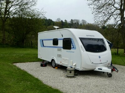

Certainly not, there are suitable caravans within that weight range. I had a five berth Sprite Musketeer TD at 1300 kg and it had everything we required. There are others avaiable for tge OP to consider with the Kona. Mind as you approach the lower end of its range choice becomes more restricted.
View attachment 7488Adria Altea 432 PX 2009 MTPLM 1100kg with 200kg payload. Same bed,bathroom layout as Sprite Alpine 4 but different dining area. Tow it with Vitara which has 1200kg rating. I wouldn't tow anything heavier from handling point of view. Kona is similar size vehicle.
