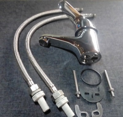

Can you not just buy the rubber washer instead of all the unit

That link takes you to domestic ceramic disc taps and possible replacement parts, it does not feature any caravan ceramic disc taps such as Reich etc simply because they do not sell them as an individual item.
So the answer is still No, the washers are not available on their own.

I would agree, zoooming into the picture shows the 3 rings are linked. I have not seen that on a domestic one. I can remember pricing one for a caravan in the past and finding that a replacement was generic. Which was much better than paying the inflated prices the stealer wanted. But perhaps prices have come down since. eg, if this were to fit the OP’s tap it’s a great price.

Anyone got one for sale one that's not leaking put a new cartridge in and still leaking so looking to buy a replacement with the same push fitting on the bottom hose. Thanks

I've put a new cartridge in and still dripping think it's going to be the whole unit
Are the rubber rings sitting on a nice clean flat surface? Can a thin shim be added to put a little more pressure on them. Otherwise, why not try for a replacement.
A very long time ago I replaced a caravan wash hand basin tap with a domestic one. It was easy enough to do just needed a couple of conversion fittings. Quality was far superior and it was a fraction of the price of the original but it was heavier. But I think caravan taps might be better priced now then at that time.
PS just seen your new topic which makes it clear you have micro switch taps so a domestic replacement will not work.

Are the pigtails screwed into the bottom of the tap - in which case you need a new tap head only and can reuse the current fittings?
This link might suggest so...

Just had another go at getting it fitting as tight as possible and I think it's sorted just put some kitchen roll between the pipes and left the pump on will check in a bit. Thanks for all your help over and out from the Isle of man

My tap.failed recently and quite frankly I just bought a new tap. The seating where the cartridge goes wears out rendering the replacement a failure. Hence for me new tap

Sorry I can't download the attachment, my number is 290107 stamped on it. It is the same as the top photo. Failing getting one I will replace the full tap for my friend.

The tap is nearly 20 years old! Sorry but a cartridge won’t fix it. Buy a new tap and look forward to another 20 years trouble free😁
