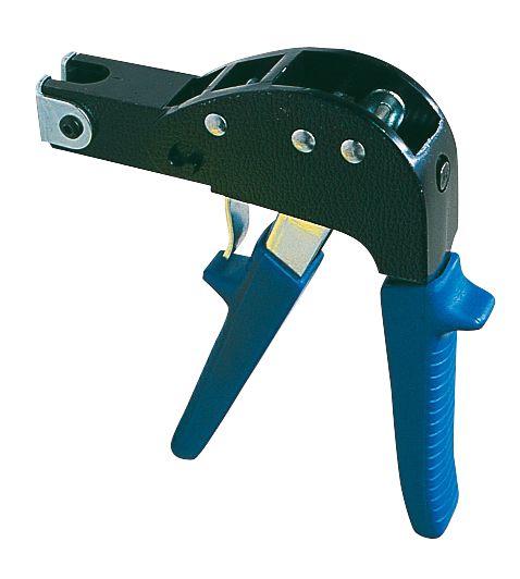

The M4 is the 4mm head 38 mm. Total length. Most plaster board is 12.5 mm. Your bracket will be 2mm or less. The 38 mm should be sufficient providing you have compressed them into their final umbrella shape.You really need to use the compression tool with these fixings and underside drill the hole by 0.5mm.
I a;ppreciate all the advice and learning as I go along, but I am sorry as you have lost me as never heard of a setting tool? :unsure:
