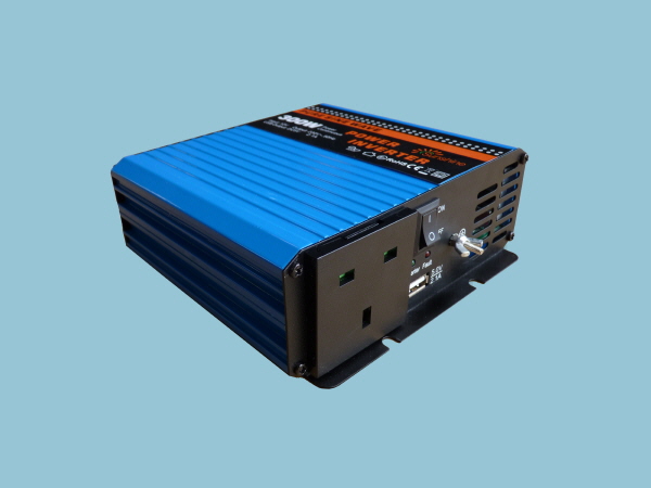

I'm looking at getting a small inverter for our off grid trips.
Because it will only be used to charge Mrs Gozza's laptop, I only need a low power one and I've found this online: The continuous power rating is more than double the power that the charger needs, and it will have a huge label on it saying "LAPTOP CHARGING ONLY"!
My question is simply, does anyone have any experience with Sunshine Solar and would you use them again?
UPDATED QUESTION- thanks to Gumpy and JTQ for the comments below - I've gone back to the website and found Sunshine Solar also have a Pure Sine Wave inverter - so, different inverter, same question - anyone have any experience of Sunshine Solar?

Laptop chargers don't always react well with MSW inverters, the magic smoke escapes from the charger😱
Possibly better to look for a 12v laptop charger.

Exactly the same comment, you may experience issues or even charger damage by using a Modified Sinewave inverter.
A lot will depend on how modified the wave form is and how sensitive the charger is to crude wave forms.
Way better is to invest in a high quality "pure" sinewave inverter; these are normally a lot more expensive reflecting the technology that they have to employ.

With so many different makes of laptops and inverters it's hard to make a decision that works for you.
Best option is a pure sine wave inverter. Less risk since it's much the same as plugging directly into the wall.

The magic words are "Pure Sinewave Converter" the output should be perfectly safe to use with a laptop charger, But as to the quality of the brand I cant help.
However most lap tops need a DC supply at a specific Voltage defined by the lap top manufacturer. There are now ways to to provide DC to DC boost converters direct which would be a far more efficient than using sine wave inverter to lap top power brick.
Check on the lap tops power brick which should give a power rating in Watts, and the required DC voltage. Im not advocating this converter as the answer, but just to show such things are available.

If laptop supports USB C charging then 12V to USB C outlet is best way to go. Cheaper, more compact and power efficient. See article regarding wattage rating.
Modified sinewave will be fine for laptop charger. Best uprate inverter by 2 or more. If laptop requires 100W use 300W inverter. Will still only draw 100W from battery but better able to handle laptop's initial turn on power surge.

I don't know where you get you information from, becasue I have had a number of power bricks for laptops, tablets, and other items like TV's and audio equipment which when used on a modified sine wave inverter either ran very hot, or produced glitches in the appliance operation or actually permanent damage the power brick. And it was not about surge current capability.
The coarse step wave output form created by the modified or pseudo sine wave inverters causes electronic ringing in motors (e.g. hairdryers) and transformers which can cause them to run slowly and over heat, or other inductive or capacitive loads. modified sine wave inverter are are fine for resistive loads and filament bulbs , but these days there aren't many items that use only resistive components.

Just for the record I bought one of these works ok for my laptop and bits, plus you may be able to get a converter for to charge slowly from USB while it's not working.
