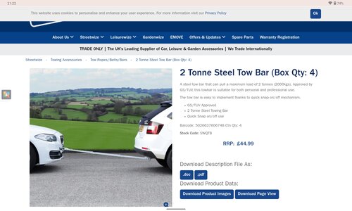

Just got this micro teardrop and I’m looking for a tow bar, ideally something bumper mounted? I came across the Streetwize 2 tone steel tow bar and was wondering if it would be much use? It does look more of a tow pole though they list it as a tow bar capable of 2 tones.

Tow poles are for towing a Broken down vehicle Your micro has an A frame for towing it. You need a proper towbar fitted to your car that meets regulations and CE marked just as if you were towing a large caravan. There is no easy way of towing. Tow bars have to be fitted to the towing points on the vehicle specified by the car manufacturer,

Berry 2025, the streetwise towbar is for rescue/recovery and not permanent towing, as the others have said you need a dedicated towbar and wiring for towing.

The simple answer is no! The towing rod is not a towbar in the required sense. Towing eyes are designed for emergency use and not as a substitute for a properly designed tow bar fitted to cars assigned mounting points and a 50mm tow ball, to take the trailers hitch.

Under a tow with that devise wouldn’t there normally be a driver in the car being towed?
Yes, it's nothing more than a rope that's been starched! An A-frame does away with the driver but they're a completely different minefield for laws/use. I've used an unbraked one a few times in my naivety of youth, not pleasant when trying to stop.

There would be nothing supporting the trailers tow hitch, and two centers of articulation neither with any yaw restraint. The trailer would try to over take the tow vehicle to on side or the other. The asymmetric point of coupling could produce some very undesirable lateral forces in both tow vehicle and trailer.
