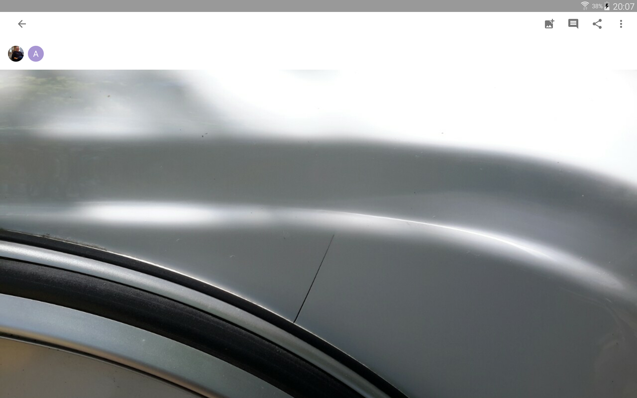

Well it's about six months since I repaired my van after reversing into a planter. What with doctors appointments, we've managed only about 400 miles since and the repair is still holding so far. Polished and blended in nicely.
24,038
8,428
Well it's about six months since I repaired my van after reversing into a planter. What with doctors appointments, we've managed only about 400 miles since and the repair is still holding so far. Polished and blended in nicely. Have tried to upload a pic bit no matter what I do, file is too large. Always worked fine before.
