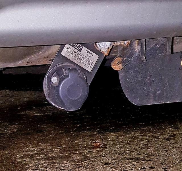

You mean this prof ....
1o5 kg on the Kuga beast !!

Craigyoung said:
ProfJohnL said:
.....The maximum nose load (S value) a tow bar can accept should be include on a data plate fitted to the tow bar. That is the maximum value, because the tow bar manufacture as evaluated the design.
You only need as much nose load that will keep the outfit stable, Most outfits do not need to go a high as 100kg....
Craig , what my worry would be that its attached to the Bolt on plate not the Towbar. My towbar one is already undreadable.
Yes that is correct.
This is the data plate the authorities would look for if they were questioning a nose load.
You must always remember the handbook for a car will have a disclaimer about the accuracy of its content, and it will often cover several different models. But the tow bar should have a data plate specific to the model its attached to.

ProfJohnL said:
Craigyoung said:
No it shouldn’t, and won’t, and Craig’s picture is a perfect example.
The towbar will have a data plate relating to itself, i.e the towbar only, and nothing relating to the vehicle.
I’m a little concerned here that focussing on the towbar data plate and nothing else may mislead the OP. For example, a towbar with an “S” value of 105KG could be fitted to a VW UP!, but that car will have a significantly lower maximum towing noseweight than this, and it is always the lowest value which must absolutely be respected. Hence my tongue in cheek editing of Craig’s previous post, highlighting that there is a difference between the towbar’s “S” value, and the vehicle specific maximum
To give you another example, the manufacturers official maximum noseweight figure for my Passat is 90KG, yet my VW approved towbar states 100KG on the data plate. Again Prof, it is always the lowest value which must be respected, also taking into account of course that stated by the Caravan or trailer manufacturer.

Tow bars ARE manufactured for specific vehicles, they have to be type approved and marry up to the car manufacturers specific fixing points. Consequently there is no way a Kuga tow bar could fit an UP or any other vehicle. Tow bar suppliers must select the correct model for the car and ensure the correct data plate is fitted.
Do not get confused with the tow ball which is a separate element to the tow coupling.
The question was about tow bars and their rating not about the trailers capacity. But as you correctly point out you have to abide by the lowest value - analogous to the weakest link principle.
Prof ! Please dont be so sure that a " Kuga tow bar could not fit say a Vauxhall Enigmia, " they might be so close that some one "COULD" fit one. Its not impossible. Therefore wrongly fitted towbar,
. But getting back to Craigs photo the information is on a bolt on Plate , onto his tow bar and tow ball , surely not legal info.

EH52ARH said:
Forget me hutch just get back to the original post question my towbar is working fine thank you.

Raywood said:
Not wanting to confuse things but the manufacturers towing limit and the towbar limit are potentially two different things. The manufacturers towing limit is the maximum weight the car can tow and the towbar limit is what the towbar can handle. If they are different then the lower one will apply.
I take the point about the disclaimer in the manufacturers handbook, but provided you are within that, I find it difficult to see any action being taken if it was wrong, which is almost impossible, I would think.
Hello Ray,
When you purchase a tow bar you should be asked the exact model of car it is being purchased for. The supplies should provide the correct tow bar assembly and data plate for the car. The data plate will be specific to the model of vehicle it is fitted and will reflect the maximum permitted static loads.
Obviously if you order, or deliberately choose the wrong one, then the wrong one may be fitted to the vehicle, but then it would not be compliant and could if detected lead to action by the authorities.

Icaru5 said:
Craig, what I was pointing out was that the Information is on a bolt on plate and not attached to the tow bar its self. My Tow Trust bar came with the info on the tow ball not the bar, the tow ball hitch was not Alko comparable, and had to be changed so no info on the tow bar. ?
