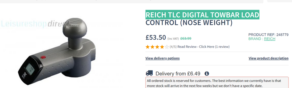

Anyone used one of these? or how do you measure your noseweight?

I had one. Did not like it. Seemed like a great idea, but twisted in use. I found it so much easier to use bathroom scales and a short length of wood.

As the device raises the trailers hitch above the the tow vehicles ball, it does not give a true measure of the trailers down force on the ball. It is claimed it compensates for this height difference, but as does not allow you to enter the relevant dimensions it cannot be 100% accurate.
The problem is exacerbated with twin axles, as the dynamic load change with hitch height is greater than with SA caravans.
There are some users who swear the results match other measurement methods, but that can only because of assumptions the manufacturer makes about the approximation of the correction factor , which may be close enough for practical use.
It is important the unit remains vertical whilst being used.
20,443
5,587
There are two models , .SA & TA. I have one but rarely use it. In fairness it is accurate and imo makes allowance for the 30mm height difference. It gave me an almost identical reading to the bathroom scales. As a guide fine but frankly the scales are still the best

I assume you put it over the car towball and then hitch the van up to it? If so, sounds like a lot of manoeuvering to me. You can take a stick and a bathroom scale to the van.
Good comment John, however the slight error 5/10 degrees will make on a reading sure beats my last lifetime of towing without a clue of the weight. My car / tow hitch is low so what happens is, the first traffic hump we reach if it scrapes we stop and shift weight to the back on the van! Anyway technically you are right, thanks.

We had one and found that they are extremely accurate however a bit delicate. I would suggest the Milenco calibrated gauge. Who cares about the nose weight perhaps being 4-5kg out as it makes no difference?

As the Prof days as the jockey wheel is some distance from the hitch it cannot give a rue reading. It was tested by the magazine some time back and it was someway out. They had a chart supplied by the manufacturer to correct this but it seemed far too complicated to me and I have no idea as to the long term accuracy. A proper gauge looks a better by I think.
