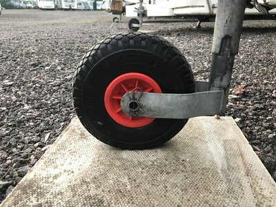

Thanks. I’ve actually tried these, they do help a bit however, I find the mat and the jockey can still dig in.If you look on Amazon for ‘2 tyre wheel traction mats’ for under £18 could you use these beneath the jockey wheel as you motor move the caravan?
Thanks. I agree, it’s almost a large ball rather than a wheel that’s needed, in my opinion.Caravan jockey wheels tend to be of relatively small diameter, and that's the root problem, small stones can (do) form a wedge in front and jam the wheel from rotating, So the issues your are having are not going to be at all easy to overcome. What is needed is a wide large diameter wheel, but there's nowhere to fit one!
Some rate pneumatic jockey wheels, I have no experience of one so am unable to form an opinion.
The easy way to reduce the noseweight is for your partner to get into the caravan and stand at the back - being careful not to go too far!It's just one of those things we all have to live with. A nose heavy trailer, loose gravel and a swivelling jockey wheel.... there is always a good chance this will happen.
A bigger / wider jockey wheel tyre tyre would help but isn't really practical as there isn't usually much room for one, you might not be able to raise the wheel high enough for towing. Any other solution, lowering the nose weight before moving / laying matts would be too much of a faff and probably won't work well.

The picture in #13 shows mine fitted to my Lunar. It was no problem.The front of our Lunar is designed to hold the ALKO jockey wheel and is a tight fit. I cannot see anything wider fitting and if it does not the ground clearance would be compromised. My alternative is to use reverse where possible, so the jockey wheel follows rather than digs in when it leads.
