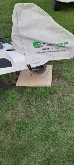

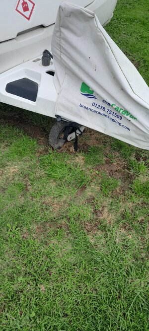

I'm on a grass seasonal pitch and the jockey wheel is sunk into the turf with all the rain we've had this summer, should I place it on a paving slab, if so do I leave the steadies down when I wind it up, I've never done this sort of thing,thanks.

IN a slightly different context (having to move the jockey wheel on a sloping pitch) the short answer is yes, leave the steadies down and then lift the jockey wheel, put the slab in place and re-lower the jockey wheel.

Being on a "soft" pitch it could well be more than the jockey wheel sinking.
Of concern here will be the probability of main wheels also sinking. This "can" lead to the steadies taking more load and the effect this has on how the van overall is supported.
This is readily "reset" by easing the load on the steadies, relevelling with the jockey wheel, and re loading the steadies.
With the van now resettled correctly you can lift the jockey wheel and on a soft pitch I would leave it off the ground; it helps avoid the van being left sagging should the main wheels sink further over time.

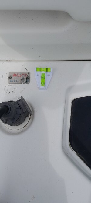

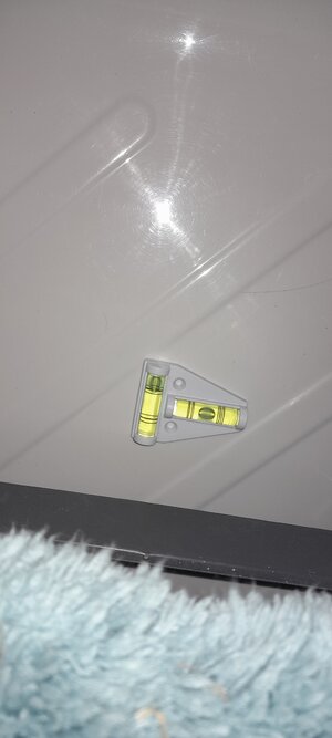

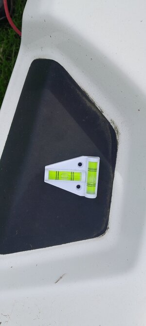

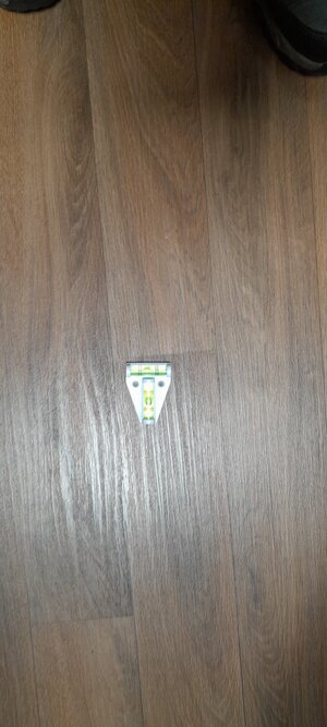

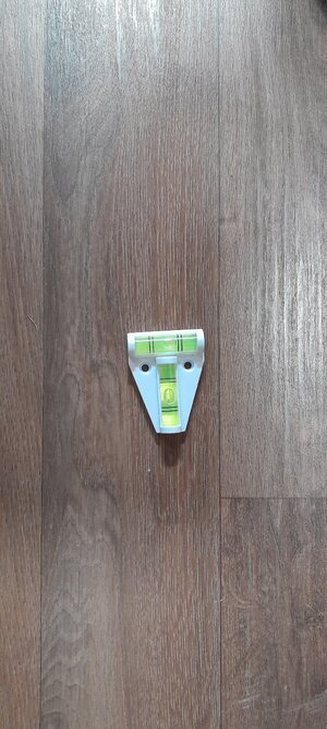

Thanks, one wheel is on a slab the other isn't.
I did spirit level checks yesterday, with a mixed bag of results.
In the van it feels like a tilt to the left, and the shower has never drained properly, the plug hole is on the right.

When levelling our van it needs to be slightly to the left ( looking forward), two reasons, 1 so the shower will drain nicely and 2, which is more important, so that Mrs does not feel like she is rolling out of bed.
I measure the level on the worktop next to the door, same place all the time.

So is the leveling achieved with the steadies or with those ramps.
12,537
4,681
Level the van left to right first on ramps, then on the jockey wheel , wind steadies down . Then after an hour or two check the steadies again, after the van has settled.
Ply Mrs H with a glass of wine, and convince her the caravan is level.
6,235
2,316
Never level the van with the steadies. Wind the steadies down once the van is level. Level front to back with the jockey wheel and side to side with a ramp ( or plank) under one wheel.

looking at your photo you may not have enough room to raise the Jockey wheel to slide the slab under - in which case you will have to loosen the steadies, tilt the van to the rear, insert the slab, then re level from scratch. As you raise the jockey so the wheel is facing exactly fire and aft when travelling, doing so when the slab is in place will hopefully enable you to level the van without the wheel fouling any of the running gear.
