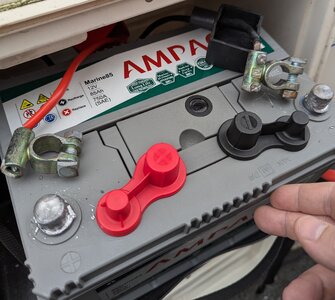

I've attached the battery in question, does it look ok connection wise. I removed the connection incase someone thinks that's my problem 😂

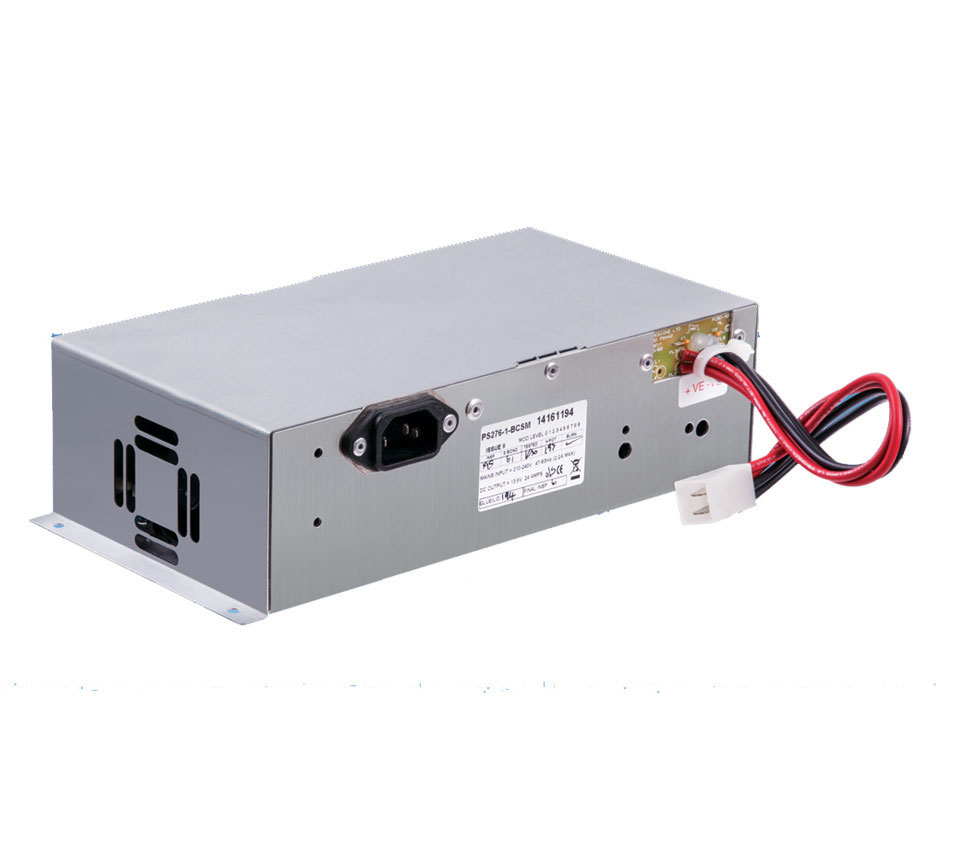

Hi All,
Just a quick update. I swapped out the charger for a new one and this has solved my issue.
The DC voltage metre on the van has jumped from 9 to just under 13v. I assume as the battery charges that voltage will go up to the 13.8v that's been mentioned here.
Thanks for all your help and if anyone's in the same situation this is the charger I purchased.
Obviously depending on your van, please check the appropriate charger for you.

Is this charger/PSU of a type that Apuljack repair or offer higher quality replacements. That company have an excellent reputation and are helpful on telephone enquiries.
If you plan on keeping the caravan, it's well worth buying one of these.
Fixes all of the inherent Bailey charger issues
My old bailey had dodgy charger turning power on and off or disconnecting battery seem to kick it into life. After fitting solar panel didn't need to worry about.
If ever thinking of upgrading to LiFe4PO in future worth buying charger that will support both types of batteries.
