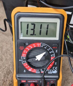

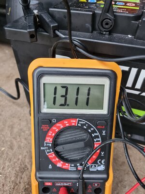

Having taken a battery off charge, disconnect the wires and leave it to stand for 30 mins minimum for the chestry to amd temperature to settle, then take the voltage reading
12,534
4,680
Border Billy, I think you also have the electical probes in the incorrect sockets for checking your battery.
If you are checking small battery's such as AA, AAA etc then your probes are in the correct connections.
But when checking a battery voltage as you are doing just now. Then the setting should be at the 20 volts as indicated by JTQ. But the positive lead should be in the right hand connector marked by V in the red box.
Have a good read up on the instructions, easy mistake to make for a new meter.

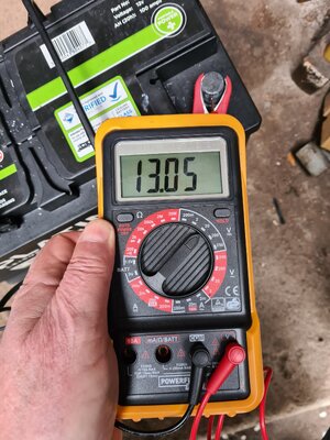

Many thanks, when it comes to electricity I am no bright spark.

That is still high for a battery not on charge, provided it has stood for several hours to dissipate what is known as a "surface charge".
LINK
It has no appreciable "energy" involved in it and does not represent the true off load battery voltage.
As it is hanging up at that, I would lean towards thinking it is indicating the battery is holding the maximum amount of energy it is now capable of holding.
Try measuring again in a couple of days.
Putting it on a modest load before measuring again off load will help knock that surface charge off, and if a modest load for a short period, will not drain it any appreciable amount off being 100% full.
