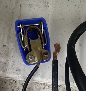

Hi, just noticed this has become disconnected (see photo below) whilst doing some checks on the caravan before we go away in a couple of weeks. The leisure battery is in the house at the moment as we remove it during winter.
Is it easy and safe to reconnect this wire to the metal holding plate? Looks like it just needs unscrewing and putting back in? The power on the mains box inside is switched off.
Advice appreciated, thanks.

Yes no problem reconnecting it. Try twisting the cores together and if you have access to a soldering iron a small amount of solder would aid clamping. Looking at the part that clamps the battery terminal it could do with cleaning using emery, or even a kitchen abrasive dish sponge. Then also a small application of white grease or petroleum jelly on the battery terminal and connector helps keep corrosion at bay.

Yes, that should be a simple fix provided you are sure that the loose wire has come adrift from the battery terminal connector as shown. I would also consider removing the other wire and twisting the copper strands of both wires together. Ideally soldering the two wires together would be a belt and braces solution. Providing the clamp can be tightened down firmly enough to secure both cables without any movement should be sufficient. Also, make sure there is no tension on the wires when you reconnect the battery. This should prevent the wires from coming adrift in future.

Great thank you for the replies :) I don't have access to a soldering iron unfortunately, but the van is going in for a service in a few weeks so I'll ask if that can be sorted to secure it further.

If fitting the cable s described above does not hold it really tight, another way is to strip maybe an inch at the end, twist the strands, then bend it back over the outer and clamp the lot. Getting the best current handling is all about contact area, so squashing the inner using the outer will apply as much surface area as can be achieved,

Soldering needs to be done with care. It can form a sharp transition between the soldered and bare wires and if the cable is able to flex at this point.. e.g when you repeatedly connect and disconnect...it can eventually fail.

I don’t like the look of that fixing. It failed so bin it. PC v msg this month is rewiring a battery box . The terminals are ones of the best I have seen. Use them. Please will one of the Mids attach the link from the mag👍

New battery terminal clamps can be purchased from any decent car parts store . The positive is a slightly larger diameter than the negative. An easy fix at little expense.

Nothing wrong with a clamp connection, just make sure both cables are secure by giving them both a tug.
