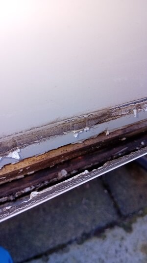

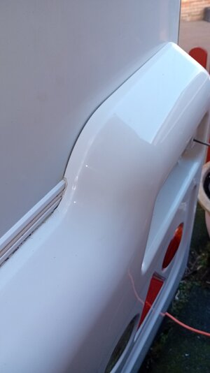

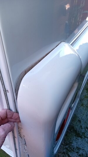

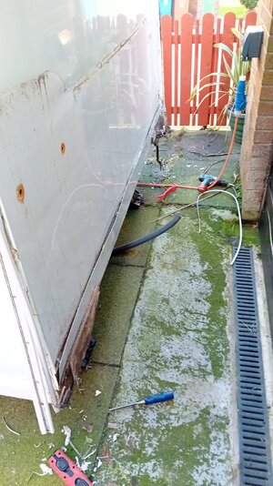

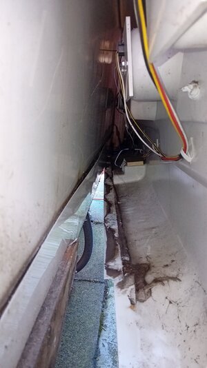

Hi , just sharing info about my 2013 Lunar 490/4.
Today I had to remove the rear light / bumper panel and discovered a rather poor design . The aluminium rear panel does not run down to the bottom , but instead , stops roughly 4 inches from the bottom. In the photos you can see where the butyl tape failed and has allowed rain water to enter .
If the upper panel had been fitted to overlap the lower , then the water could have dripped off . The rear light panel had never been sealed at the top and a local caravan engineer assumed that this was because the back panel ran to the very bottom .
This caravan had previously a new bathroom fitted but the true nature of the leak was never repaired. I am now repairing the floor as water has entered at this rear panel , cassette toilet door and also a small crack in the corner of the shower tray.
Two weeks ago I had booked the van with this engineer who was going to repair the floor and fit a new water heater for £950.
At that time he had discovered the leaking cassette door . I later decided on doing the repairs myself.

Hi , I resealed the rear lower panel with fresh butyl tape , a row of small stainless self tapers and sealed over with Sikaflex 522 . Refitted the light panel and side awning trims and sealed the top of the light panel with 522 .
Not the sort of job you would want every Saturday. Removing old butyl tape must be the worst job in the world ..
