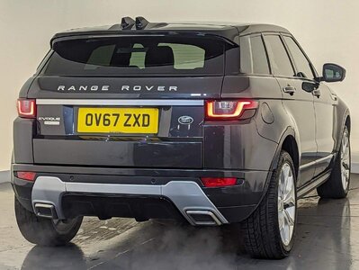

looking at the video although difficult to be sure, however looking at the rear I don't think it looks like the Evogue but more like a normal RR or Discovery.
Look at the rear lights of the car in the video. Then at this Evoque.
