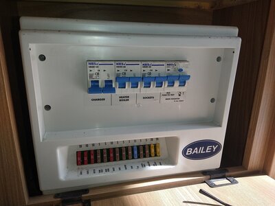

You could always pull the 12V battery fuse in the EDU( second from right in attached photo)
