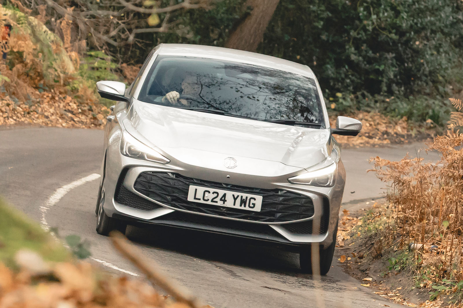

Over 10 years ago I bought a new Subaru SJ Forester, one reason being that it was specifically designed to cope with the new offset impact test. This test was introduced because safety authorities were questioning as to why there was there were more deaths or injuries during frontal impacts when the various makes of cars involved had good frontal impact scores under NCAP and other nation’s equivalent tests. It turned out that offset frontal impact performance was the cause. Hence the introduction of that test into NCAP. Nice to know in 2014 the Subaru topped the class by a substantial margin.
Now, three days ago an NCAP release shows the current MG3 had a critical failure of its drivers seat restraint. It happened on the NZ and Australian NCAP too. Yet because the car did well in other areas and its electronic safety aids are good it was still awarded 4 stars. The NCAP press release details that such a failure of seat restraint has never occurred in 28 years of testing, and furthermore they accept that their well established procedures for scoring cars doesn’t allow for a critical mechanical failure. They even strongly recommend that potential buyers of the MG3 look at other cars.
What is concerning is that MG are now modifying new build cars and in October will release a modification to the air bag which didn’t perform well. But MG have no plans to modify existing cars. NCAP have now passed the responsibility for deciding action on existing cars to national authorities IE DVSA in UK. So until a decision is made wrt any statutory recall existing owners are at a risk that these days should not exist, and the value of their cars will inevitably drop.
My daughter bought a new MG3 in February this year, so is affected by MGs intention to do nothing. She did not use dealer finance as she got cheaper finance elsewhere. I’m wondering where she might stand with respect to the Consumer Rights Act 2015 such that if MG continue to do nothing could she reject it to the dealership? I have submitted my “complaint “ to DVSA although by now they will be well aware of the issue, and contacted the BBC consumer affairs department suggesting they could air the issue. The Dealership and MG UK are next on my list. I have other thoughts in mind but plan to give it a few days, and with the motoring press alert to the problem, MG might see their planned inaction to be very bad for business.
