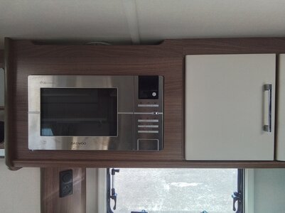

Let's try again!
Still no photo.
Let's try the other way round. If your instalation looks like the photo below. There are four screws holding the hinges for the cupboard to the right of the microwave. Two are longer and go through the side panel and into the microwave surround to hold it in place. Remove these then pull the top of the surround forward - there are two spring clips on the top. Once tilted forward the surround should lift upwards and pull out. After that you will be able to see how the microwave is clamped into position.
