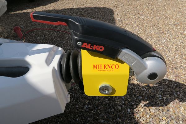

Paul , or anyone can I pick your brain , caravan is back at storage at the minute so I can't go out and check ; are you saying that the lock that we have we can travel with it locked in position whilst on the car whilst towing ?
Hitched on as normal then replaced back on
Jun 20, 2017
166
Craig
looking at your picture it appears that the stabilizer is not fully engaged with the hitch lock fitted (that is exactly the same as how the Alko version sits too).
so my answer would be no, you cant travel like that?

Hi Craig,
I believe that you should only use the hitch lock whilst the van is stationary.
If you were to be involved in a major accident on the road, it would hinder the emergency services, should they need to unhitch the unit from the car.

Craig,
Kevin & Lappy are right... The hitch lock does prevent the full engagement of the stabiliser and it would prevent unhitching in an emergency. I have only applied the lock while hitched at the services when the car was left unattended. I obviously had to disenage the stabiliser and just left it up.
It was after doing this I read about caravan thefts from services in broad daylight!!

Kevin2306 said:
The Alko version also prevents the stabilise from engaging fully.
Kevn
Do you mean the handel dosnt fully go down? It’s Stange because over here that’s the USP for an Alko lock on alko hitch that you can drive with it locked.
24,162
8,504
Just popped out to see what mine does. The hitch clicked down over the red plastic ball. The Alko lock in place and stabiliser handle closes right down. However I wouldn’t tow with it in place and locked. We never leave van unattended at services anyway.
Jun 26, 2017
445
17
10,685
Just as Newdur and Clive say, by design, the Alko one allows the stabiliser to be fully engaged. I would never tow with it on, primarily because of the significant effect it would have on the noseweight, but I always put it on whenever we stop at Services, or even if we have the outfit parked up in a holding area on site on the last day if ever we stay to use the facilities after vacating the pitch ...

As others have said the Alko Premium Safety does allow you to fully depress the stabiliser handle & Tow with it on,
There is no law in the UK to stop you towing with a hitch lock it’s purely down to personal preference,
My feelings are it would just be more hassle in the event of an accident or breakdown so I don’t bother & having had a caravan clipped by something in the services I never leave it unattended anymore
