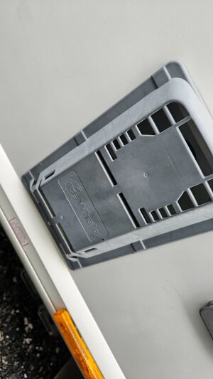

Agreed re ventilation. But the OP needs to look at the vans fixed ventilation for any blockages. Some vans can form drafts with large vents in the floor and some will try to cover these.

Ventilation points can be found where ever you have a gas appliance,these are an essential safety measures in case of any unwanted gases,they allow propane plus other gases to evacuate outside, it's not unknown for these to be covered an extremely dangerous practice.At various other points similar vents can be found to allow a through flow of fresh air,on mine there is a large hole(size of a postcard that has a mesh fitted)under the front chest between the two bunks,I usually leave window catches slightly open.Always make sure before moving your van all windows are secure.
