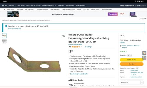

It's not only Touareg owners that are affected. It's most vehicles that have Westfalia towbars manufactured before the magic date. However various accessory manufacturers do offer specific cable anchorage adapters for such towbars.

Although there are devices for fixed and detachable swan-neck towbars I've never seen any devices suitable for the "electrically-deployable" towbars used by VW Group - if you know of any website links, I'd appreciate seeing them.
