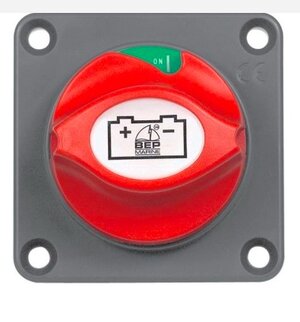

Used to get that all the time on my clubs and my boats (RIBS used for Diving expeditions) The internal mechanism just turns and then engages a brass/phosphor bronze arm onto the two contacts.It doesn't wipe the contact surfaces either when making or opening the switch, so the surfaces slowly oxidise and become slightly resistive On some I've had the contacts actually warmed up and slightly melted the body exacerbating the fault . It takes longer in caravans than in boats due the milder atmosphere , and sometimes they never fail. Attached is a marine grade isolate switch which is sealed . Given how clever modern motor mover controls are (when not use the micro goes into 'sleep' mode taking very little power from the battery and the fact the isolate switch is not in a really accessible position if something did go wrong and the mover stuck on you wouldn't be able to stop it !
The switch fault can also be caused by just rotating the switch and not pushing the switch in as you rotate it, it erodes the edge of where the switch goes over a sort of cam, this then means although the switch passes some power it doesn’t hold in place as it should
