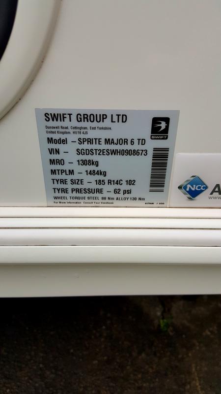

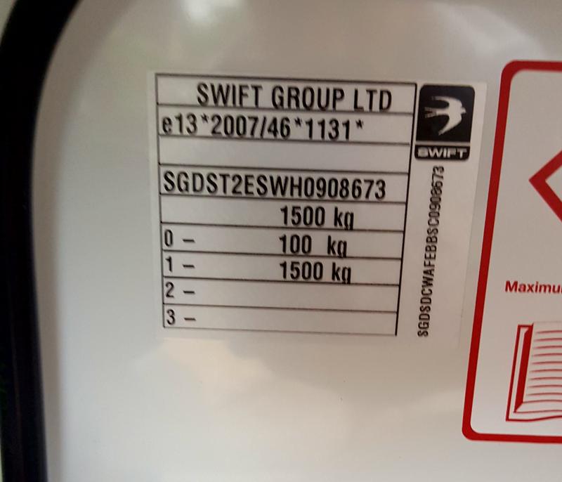

So after getting mine back and looking round I've noticed numbers are different compared to outside compared to the gas locker , top is front locker , lower one is beside entrance door .
Craig .

That doesn't surprise me but the details shown in the lower picture don't comply with the regulations. The type approval number and the maximum permissible axle loads and noseweight are missing and details that are not legally required (model designation, MIRO, tyre size, tyre pressure, wheel torque) aren't clearly separated from those that are required.

The lower picture information label is pretty standard for UK manufactured caravans. Give its couple of years and Craig's enthusiastic washing and it will be illegible anyway. I note the difference in maximum weight between the door label and the label in the locker. Little wonder that some get confused

I have a similar but slightly different question. Again an Elddis van. Door sticker says -
MIRO 1132 KG
MTPLM 1310 KG
Tyresize 185 R14 102
Tyre pressure 57 psi
and gas cupboard sticker says -
1310 KG
0- 100 KG
1- 1500 KG
2- N/A KG
Door sticker is almost illegible and likely to fall off next time it's washed so would this suggest that in reality I have a safe MTPLM of 1500 and that 1310 is "just" a marketing number kept low for people who need a low number?

Your door and locker sticker plates both show MTPLM of 1310kg which is set by the caravan maker who are the Design Authority for the caravan. The 1500kg is your axle load set by the chassis maker. In answer to your question the topic had been discussed a number of times and there are two views as to your legal position if you were to load the caravan to an axle load of 1500kg. I’ve yet to see any details from court cases/DVSA that rule either way but my view tends to err in favour of the lower MTPLM as set by the caravan designer/ builder. As they have set the MTPLM at 1310kg with tyres rated to suit that weight, and they know the weight distribution of the van and will during development have tested it on towing trials. A caravan is different to your normal trailer which just carries stuff to and fro and generally is loaded low down. Your higher axle rating is most probably down to the fact that the maker decided to rationalise production by having one axle set for a number of different caravan models.

Cheers. I have a trip pencilled in to a local weighbridge to see where we are relative to the capacity. We think we are being frugal at the moment but having just struggled to fit a motormover I realise I've added a bunch more weight so better safe than sorry.
If I'm underweight I know we can add a bit more stuff. If overweight we can work out what we need to shift into the car or get shot of. Ideally want to keep the van as light as possible as we plan a few mountain passes in the summer.

Given the higher axle rating you may be able to buy a MTPLM upgrade from Eldiss to give you a bit more margin, but I doubt they would take it right up to 1500kg. But with any consideration of an upgrade you then need to check tyre Load Indexes, and the car’s specification too, including the specification for the towbar as well.

Hello Clive,
In this case I seriously doubt the MTPLM can be raised: the plate the manufacturer may change is the NCC sticker, not gas locker one. The NCC plate already matches the trailers EU plate.
