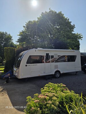

Hi John,
I initially opted for a Thule omnistor, to
be fitted by the supplying caravan dealer while it was serviced.
However, on closer inspection they said it was impossible due to the placement of the solar panel and ariel. Moving them wasn't an option.
So they fitted a 4m Fiamma F45s which attaches to the side/edge of the roof. So far im really happy with it, tho I haven't used it in the "wild" yet. I think the cost for supply and fit was around ยฃ1200, so much cheaper than the Thule.
I purchased a isabella buddy awning to go with it, due to its flexibility, one side of which can be seen in the picture.
The only downside side is you dont have the option to use the awning rail on the side of the van as that's covered (which is why I initially wanted the roof mounting) but I wanted the canopy to cut down on stressing when putting the awning up as ive limited mobility in 1 shoulder - so im not really fussed ๐Ÿ˜Š

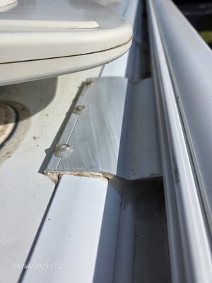

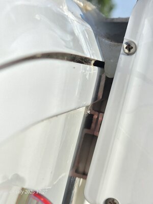

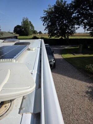

Do you know if they had to drill or was it bonded.

There's 3 metal brackets fixed to the roof. 2 bolts/screws in each, that go through the roof. The dealer sealed it in well with silicone sealer & the fixings inside are hidden. It all looks a really clean job. Im out at the moment, but will post a picture of the mounting brackets later. ๐Ÿ˜Š
