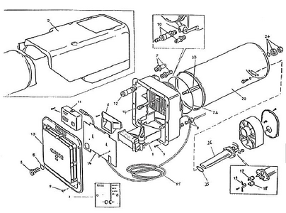

First of all the appliance you have will be at least 25 years old. Spares are getting harder to find these days.
The burner control module (BCM) is responding to a demand for heat, and tries to ignite the gas, If the flame sensing probe is unable to receive the flames signal the BCM continues to fire the ignitor for about 10 seconds before locking out, with a red LED on the control panel.
As you have already changed the BCM I assume for a remanufactured one, we can eliminate blocked burner bar, and flame probe position,
That tends to leave low gas supply pressure. or perhaps missing parts in the flue cowl assembly
If you look at this diagram you can see the BCM, to the left of it there is a cast metal flue cowl (#4) and a larger flat metal plate with some high temperature ceramic matting (#16) and of course the DMC exterior cowl. Theses must be fitted to enclose the burner fin pack. Without them the flame will be unstable which might be causing your problems.
Another possibility is the caravans gas supply may have been contaminated with an oily substance which tended to collect the the lowest points in the gas installation like the cascades inlet coupling. This might be restricting the gas flow.
