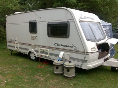

we have a jaguar xe, can tow 1500 kg. Our Lunar clubman ck fully loaded is 1265 kg. Towbar is rated upto 145 kg but jaguar says 75kg nose weight. Can't get below 85 kg without loading rear of van . How do we adjust weight? Front locker empty.

I had a nose heavy caravan and had no option but to move some load towards the rear. Getting to 75kg from 85kg isn’t that difficult. Move something behind the axle. Ensure front hot water tank empty, I would add 2 litres to the cassette and 2 litres to the flush. Plus sometimes putting my 9 kg tool bag at the back.

It is a horrible predicament, what do you have under the front bunks? Is your water heater empty?

Do you have bench seats in the front of the caravan? Can you move the cushions to the back of the caravan, maybe stowed in the shower?

In my old van which had a rear bathroom I used to use the toilet flush tank to reduce the nose weight😉

We have done the same, also our cooker is just behind the axle, so the bottom of that we put heavy pots and pans, every little bit helps.

Where do you carry the gas bottle if the front locker is empty? We were towing one behind a 2011 Ford Mondeo Estate and I don't recall issues getting the nose weight down, but it may have had a higher nose weight allowance.

When getting our previous Cabrera right the item that we moved that put the world to rights was the jack and wheel nut spanner from front offside locker to the very rear - I reckon it was effectively a -5 at the front and a +5 at the back...

Tow bar and dedicated jaguar electrics. Have to put bottle in car.
