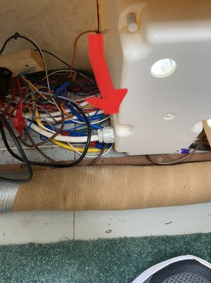

Ive jus returned to the caravan from being out today. And the smell was strong again. It seems to be very strong wen i stick my head in the battery compartment. (Although no battery) seems to be strong at the input wer the wires come in the connect the battery connectors.

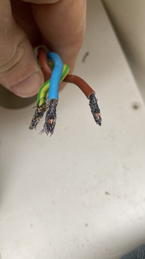

Hi. Thanks for the reply. Just took everything apart and seems its now may also be the mains lead from the fuse box to the 110 connection. As this is smelly too. Unless the whole overheating/charging has caused the initial rotten smell. Which i suspect as started to burn the mains lead out.

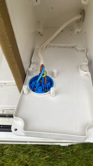

I am unsure of your reference to 110 unless it was a typo?
Hi. Sorry. I mean the main power lead from the mains fuse box to the connector which you use to hook up.
