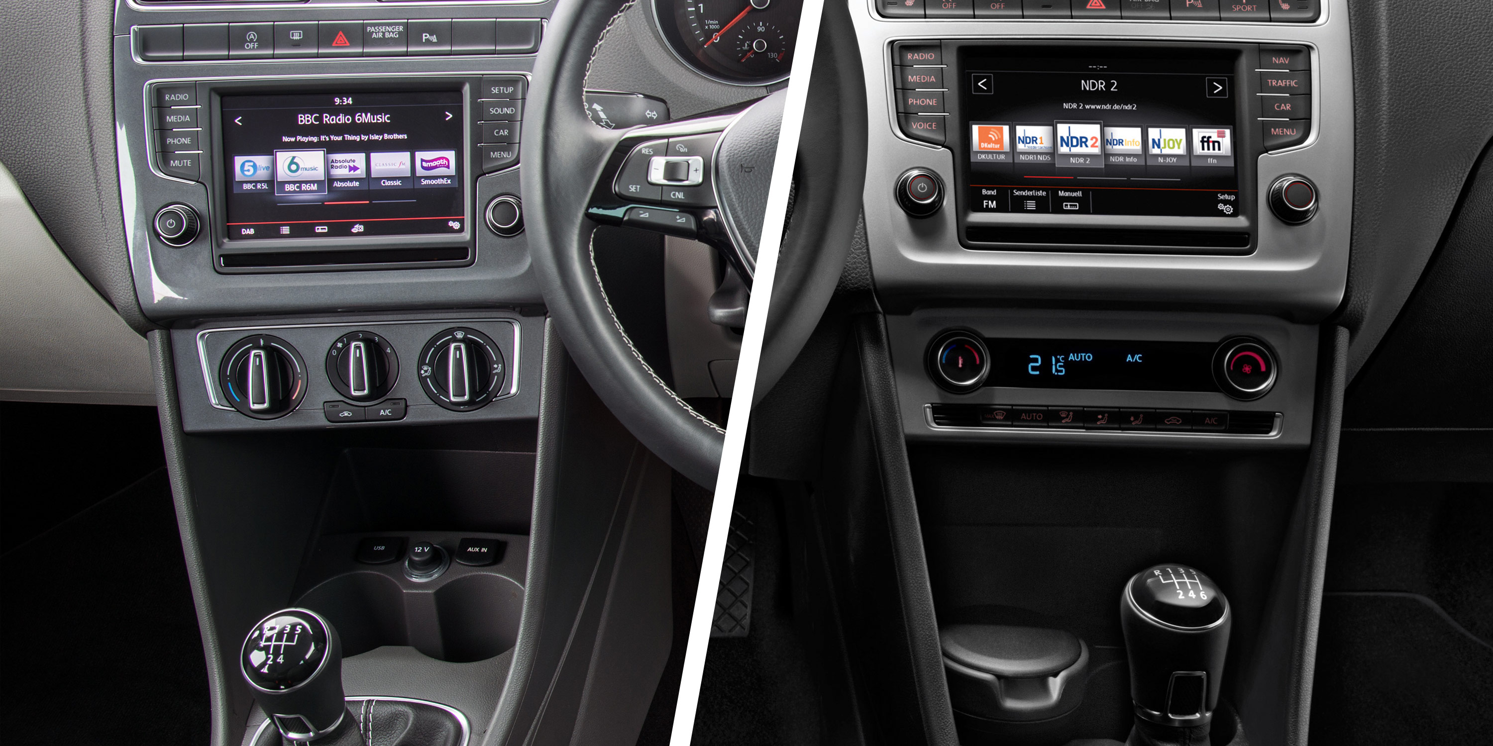

What is the difference between climate control and air con???

Thanks Hutch. Mines climate control then, usually set on syinc at 21degs all year. If people ask still call it Air Con

The Jeep has climate control for the front passengers and also for those in the rear seats whch they can adjust themselves. When in air con mode they cannot adjust their zone.
I would suggest that if the rear passengers can have some control over air distribution this is limited if the driver has not turned on the AC. And it will be simply that, distribution. No cooling or drying will be possible.
Normally, if the driver selects CC (just auto on my car), the AC comes on by default.

I've never seen the value in two-zone control - as soon as the air comes out of the vents it mixes with the air from other vents - it's not like there's a barrier between the driver and front seat passenger - and three/four-zone seems even sillier since the air from the front vents travels rearwards anyway before being extracted so the rear passengers can't really have independent temperature.

Same with mine just an auto button, on all year. The settings for passengers temp wise is small.

On the Jeep you have to physically select climate control auto or air con. Although they are basically one and the same thing and not separate, the difference is the way it operates. If selecting air con, temperature selected for CC stays the same. Fan is at mid position and needs to be manually adjusted to increase or decrease it.

Some cars have twin AC units - the Porsche Cayenne, Audi Q7 and VW Touareg siblings have a separate AC unit in the rear wing when the four-zone option is fitted.
