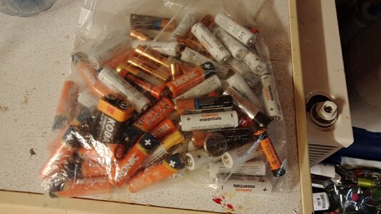

Ditto - I put them aside to remember to take them to the supermarket to drop in their battery recycling bin, forget .............................................. only to then pop one back into an appliance.
