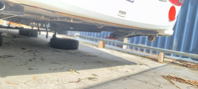

From a forum I'm involved in (New Zealand). Just passing this on as I have no knowledge of what's really involved
Re: Lowering the axle, lifting the van
Unread post by Nut17 » Wed Oct 05, 2022 7:44 am
I achieved an 80mm chassis lift using a system similar to your idea in December 2019 on our then almost brand new Elddis Supreme 860. I fabricated some channel section spacers using 40 x 40 x 4 mm L iron. Some large washers and oversized holes were needed to match the large recessed swages. I also replaced the tyres with a size larger and taller aspect ratio effectively providing another 20mm lift.
Some photos below. The first one shows the original ride height but on some X VW Golf 15" wheels which ended up being unsuitable as the off set was incorrect and did not provide sufficient back clearance.
Attachments IMG_4345 (3).JPG IMG_4591.JPG IMG_4590 (2).JPG IMG_4588.JPG IMG_4587 (2).JPG IMG_4585.JPG
Cheers Chris

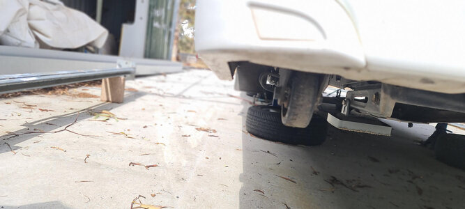

Hi everyone,
Thank you for your many responses. I realise by your many replies that I was not totally specific in my question.
First of all, Professor John, you have been doing your detective work as yes it is indeed I in a previous post that was looking at the Adria range however decided to stick with the Swift Challenger.
I have had my van for 9 years and I did look at a height modification back then, however, dropped off the idea. I'm now revisiting the concept as there are a number of workshops here in Australia that offer this service and have raised a number of satisfied Swift owners van heights.
Shortly after I purchased my 2013 Challenger, Swift introduced a model specifically designed for Australian conditions such as raised height, beefier chasis, higher ATM etc.
Because I have done so much to my van, I was hoping for a height modification to complete the picture. The other alternative would be to sell my van and purchase the Australian model.
The one thing I don't want to do in any modification is to interfere in the dynamics of the van. Being lower to the ground does have it's pros. As I said, I have survived the past 9 years, seems a little counter productive perhaps in starting now. The money may be better spent elsewhere such as an alternative to the notorious Swift Panoramic Sunroof crack.
I may install a couple of trolley wheels as illustrated in the attachment on each rear corner to assist in the van from bottoming out.
