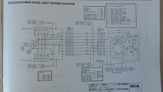

Are these fuse "boards" on the back of the front bulkhead, "normally accessed from the side bunks. I have never had problems with my road lights so have never had reason to find any fuses, maybe our van doesn't have any. I must check the wiring diagram.
Just gone through the road lights wiring diagram, and there are NO fuses on my 2013 Coachman, next time at the van I will double check visually. Two lots of terminal blocks though.
