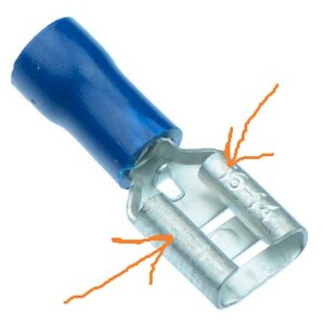

Connections , connections, connections,! check the spade connectors on the motors these are exposed to the weather (even if inside covers) and can become corroded /dislodged( did a powrtouch the other week) simply removing them and crimping the edges 'slightly' (see photo) and replacing can help to clean the mating surfaces( the ones on the motors are larger an usually insulated type. The other thing which can become intermittent are the brushes on the motors , they can 'stick and not touch the commutator , taking them out can be a bit of a pain , but they may develop a step in the sides, they also can wear out. the other thing to check is the motor connections in the base unit are tight
