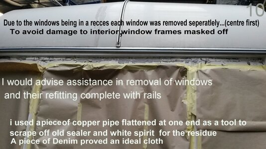

What year is your caravan, and which windows.My 3 front windows are in a glass fibre moulding which is recessed for the windows,this makes the removal of any of the windows longer to remove,they will not go sideways nor lift and in hook out.

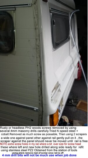

Here is an image I took whilst doing a complete reseal of all my aluminium rails and joint covers,I have an abundance of images on the removal of all aluminium trim and the cleaning and refit also all materials I used,I will post others,please check in the vintage section of this forum,some images have been posted previous00_012705.jpg
