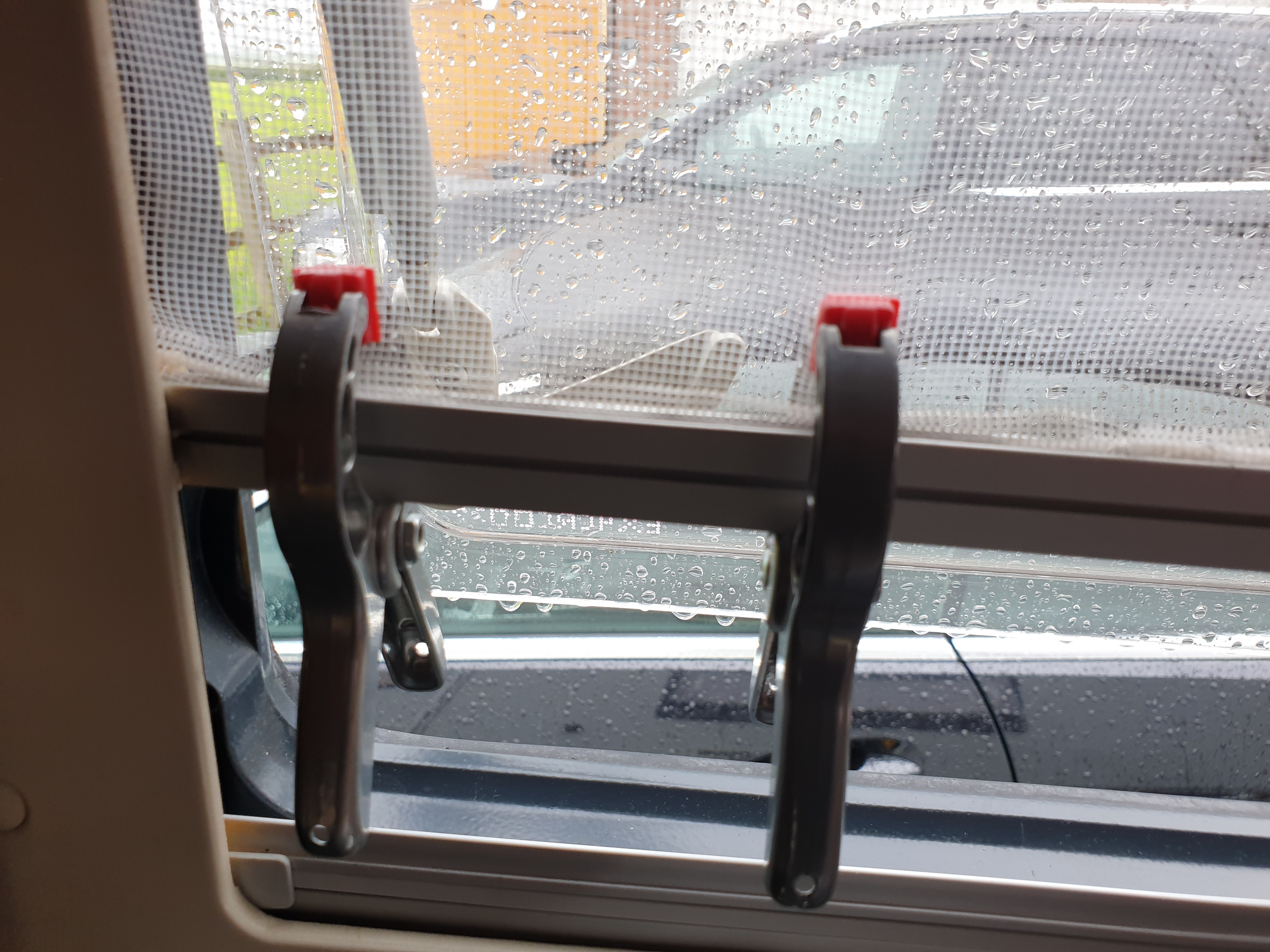

To repair you will need to take the blind off the wall. I replaced a torn flyscreen before
There is a very thin round plastic strip that holds the fly screen into the rail with the handle on. You can just about see this strip in your photo.
When made at the factory this plastic strip is either slid into the rail from one end or the rail crimped around the strip.
Once you have the blind off the wall don't try to pull out the strip and flyscreen out from the aluminum rail, It will end disaster. And you will never get it back in. I speak from experience.
The only thing you can really do is to use something that's thin and plastic and try to push the flyscreen and the plastic strip back into the aluminum rail. Taking great care not to damage the fly screen. It takes time and quite a lot of force
Good luck you will need it.
Mar 19, 2019
76
Just a quick update on how I've repaired this without removing the blind, used clips to hold the fabric down, slid it back into the rail, then poured super glue into the rail.
