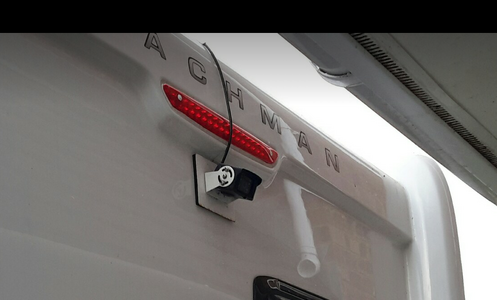

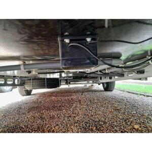

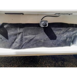

Good feedback from everyone. Eventually installed on top of the caravan number plate. The 12v was taken from the number plate light. I ran cables down through the cavity using a stiff piece of wire for the pull through. I then mounted the aerial module and minature psu in a plastic project screwed on the bottom of the van about one meter in from the rear. Reception is great. I'm still deciding on which is the best place for the monitor. Any suggestions?

I've attached photos. 12v taken from side lights and camera cable fed via side lights aperture. Sikaflex 522 used to reseal side lights. ABS box screwed to base of caravan contains aerial and psu modules. No extra holes drilled
