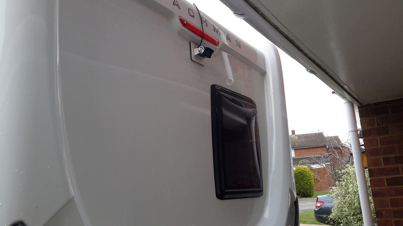

Although my camera is a wired unit, I mounted the camera to a plate then stuck the plate to the caravan using the thick number plate attaching pads. Been there over three years, to remove use a piece of 18swg wire to cut through the pads.

It't hard wired from the camera to the screen, but I have fed the wire down the right side off the caravan in the awning rail, under the A frame which then give me plenty of cable to hook up to the screen in the back of the car. The screen sits forward of the gear select in the Cubby hole, so in theory legal. A. I dindn't link it to the reverse light, as I want to view behind me. Its great. , have to vary colour and contrast to suit the sunlight or night. Would not be without it now.
