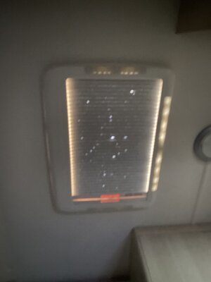

I’ve noticed a couple of the folding shades for the roof dome have splits in the folds (see photo).
Without replacing them - which I guessing would cost a fortune - is there a quick fix that could remedy this small but annoying problem?
Thanks in advance, as always 👍

How old is the caravan?
My old girl has blinds just like yours. With age the fabric wears , fails and lets light dots in.
We have tried various remedial methods , tapes , glues nail varnish . Some have worked short term but none long term.
I know some people have made up their own blackout curtain securing it to the frame with double sided stick velcro.

I vaguely remember someone posting that they had replaced a similar blind with one from ikea?? Think it was on here?? Serious googling may find something. Try You tube as well.
2012 - I could live with it but an inexpensive easy fix would be great 👍
IKEA? Worth checking out - thank you 👍

Awesome, thank you for this. Would I need to take the frame off?
Possibly, but it's not difficult. Look for small plugs the same colour as the frame, tease then out with the corner of Stanley knife blade to reveal the Phillips heade screws that hold the inner frame in place.
Another option would be to use some black-out blind material, cut to size, and fixed to the frame with self adhesive velcro? A bit of an "all or nothing" option, but certainly effective!

Found this, if it is any help
Probably more expensive now
