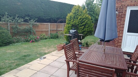

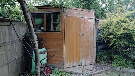

Our one pictured was dismantled 6 years ago to put a new flat roof on. But the water runs off onto a brick wall and then back onto the shed.
It is 25 years old, and a cheapy from B and Q, but it's Ok.
Small shed is the Caravan stuff and Motor bike stuff.
And now that the council have given us 4 different Wheely bins they stay next to it. So not a good outlook.
