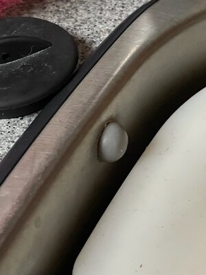

Hi David
As requested by the Prof and John C we need to know your make model year and photos. My Bailey for example has three covered screws, But the waste must be removed first. In my case it means removing the fridge first. So instead I reached the tap and pipework via the fridge vents,
